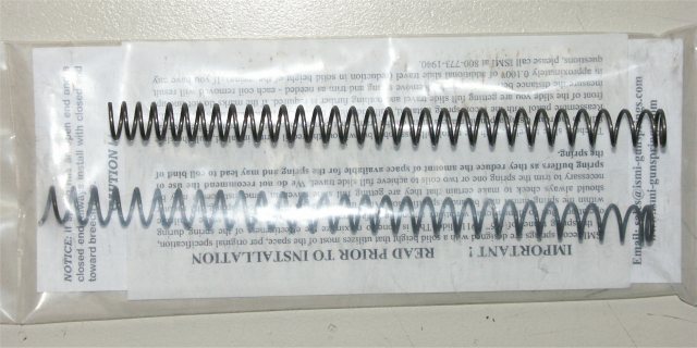

As soon as I received them, I removed the recoil spring from my .45 1911 and replaced it with an 18 lbs ISMI chrome silicon one. In the picture below, you can see the removed spring next to a brand new ISMI spring. Obviously, the removed spring has lost more than 1/2" of standing length.
The new ISMI spring was installed in my pistol on October 28th, 2003. Since then, it has lost only .2 cm (2 mm) of its free length. In other words, during those seven months, with a few hundrend shots fired, the ISMI spring has lost only .08" of standing length!!
I've measured its length at installation and it was exactly 17 cm. As it is today, its length is 16.8 cm, an amazing loss of only 2 mm!!
I guess this is quite a good performance, considering that the spring I removed from my pistol, and which has been in it for around four months, had lost more than .5", with the same amount of rounds fired through the pistol. As far as I am concerned, ISMI springs have won a place inside all my pistols.
