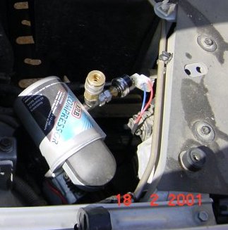

During a trip to USA, I made the first step towards the lockers :-) . I purchased the ARB compressor and the their inflation accessory (a kit which allows you to use the compressor to inflate your tires). I have installed it in the car, where the normal air filter box was. Fitting everything together took me some time. The T-adapter which ARB ships with the kit, didn't properly fit in the hole designed for it. I had to purchase some special tool and another T-adapter, in order to fit the pressure switch and the air hose adapter on the compressor. It was nice to hear the sound of the compressor, when I first started it! I tested a bit to make sure that the pressure switch works and I left it sitting there. The switch was installed in the place of the coin slots on the center console (the coin slots didn't fit the Greek coins anyway), and I've created a plastic base (not shown), where the lockers switches will go, when I'll get them. The device you see in front of the switch, is the Kenwood 732 VHF/UHF radio, an excellent tool when you are out in the mountains, to get in touch with other radio amateurs. When I ordered the compressor, I also got the "inflation kit", which includes a T-adapter that you fit on the compressor, and an air hose clump, on which a rubber air hose can be attached. Click here to see how everything fits together. With that, you have a very nice air supply in the truck, which allows you not only to operate the Air Lockers, but also to inflate the tires when the need arises. Click here to see my son doing the hard work.
